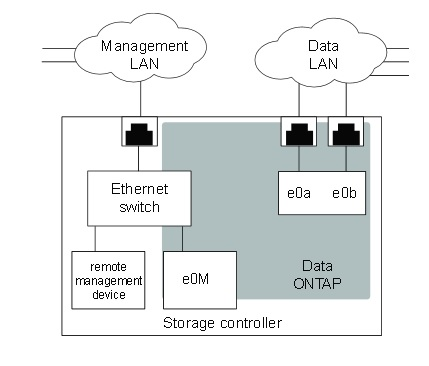

The e0M and SP/BMC interfaces should always be in the same subnet when these two interfaces share a single physical port.
  • Logical interfaces (LIFs) configured on the e0M interface, and the SP/BMC network interface, both connect to the external management network by means of an internal network switch to a single physical port (graphically identified as the "wrench" port).
  • IP addresses for both interfaces must be on the same subnet directly reachable via the wrench port

  • The e0M management interface and the SP/BMC network interface are connected to two ports of the controller's internal switch.
  • A third port of the internal switch is connected to the external Wrench port (RJ45) which allows access from outside.
