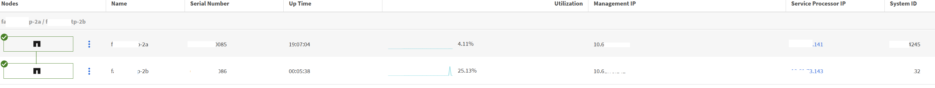

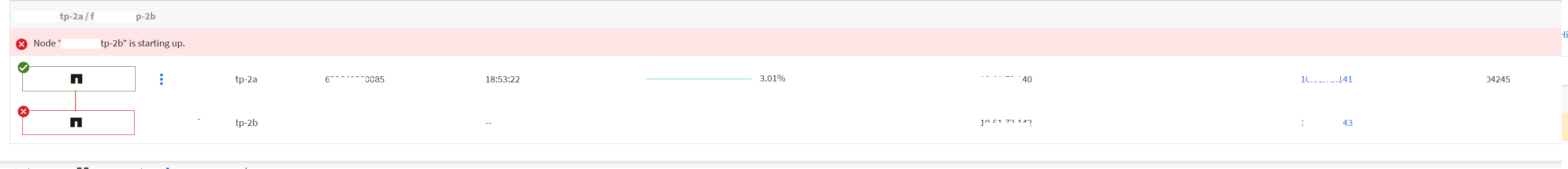

  • Node Status:
  • Green  Check Mark:  Node is running and healthy status
statuses displayed in ONTAP System Manager indicate
  • Red Cross Mark:  Node is in shutdown or starting status

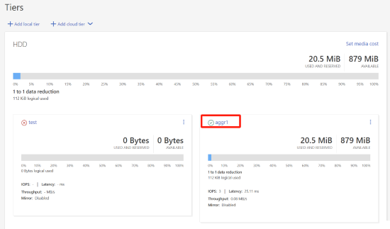

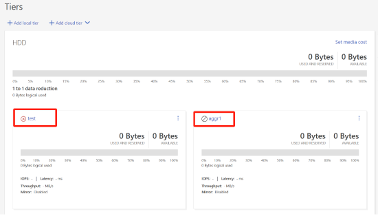

  • Aggregate Status:
  • Online:  The aggregate is online and serving volume works.
  • Offline:  The aggregate is offline and cannot be used.
  • Restricted: The volume of this aggregate is unavailable to client but few operations such as aggregate copy are allowed.
Volume is accessible and serving dataAggre status
