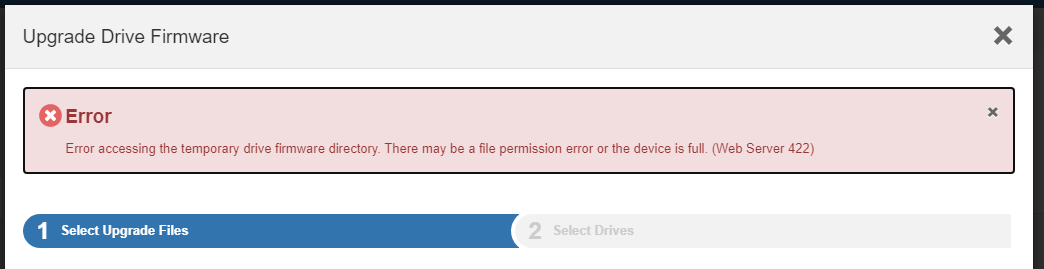

- During Drive Firmware upgrade -
Error accessing the temporary drive firmware directory. There may be a file permission error or the device is full. (Web Server 422)
