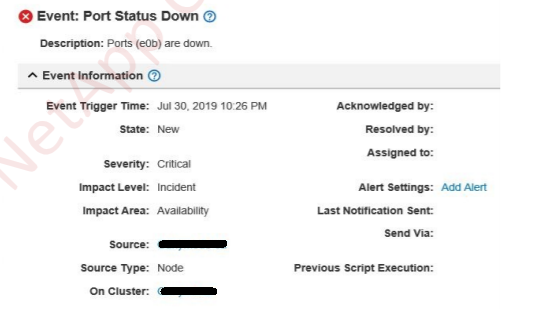

  • When Active IQ Unified Manager detects a network port of which link status is down, it reports Port Status Down event for the node like the following example
How to prevent Unified Manager from reporting
