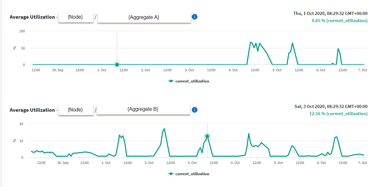

    • (Local Tier - Aggr Util%)  Please note Active IQ does not provide a Peak value so cannot be used to spotlight available performance capacity, however current utilization spikes can be viewed:Active IQ Unified Manager
      • Be aware that systems with no data aggregates or with backup/disaster recovery roles may exhibit low-performance headroom for aggr utilization due to low drive count or periodic high volume sequential IO.
      • If increased per IO latency is not a concern for the system in question then instances of this risk can be ignored.
