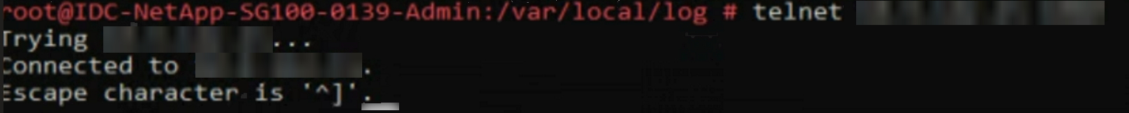

  • Telnet to the proxy IP (telnet <proxy_ip> <port>) shows connected:
    • <port> will be the port defined in Grid Manager under Configuration > Proxy settings > Admin > Port.
