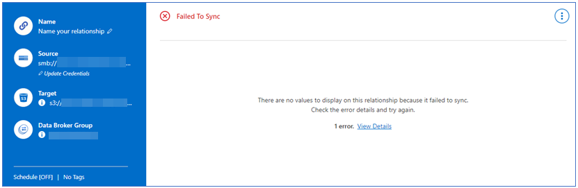

Issue
Copy and Sync jobs failing with error:
Failed to Sync:
Failed to connect to the source or target
