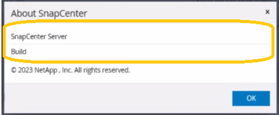

  • May also see Upgrade Mandatory in the Status in the SC Hosts UI even though an upgrade was successful, and may see:
