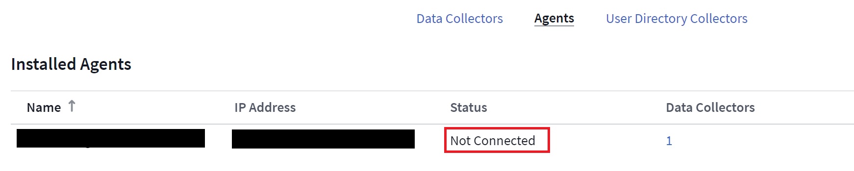

Issue
  • Agent Server is in Not Connected status in  Workload Security > Admin > Data Collectores > Agents
