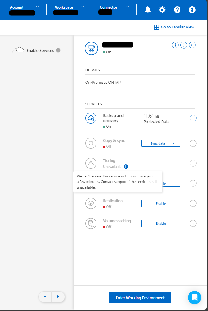

  • Tiering Service is Unavailable status in Canvas
Tiering Service is Unavailable status on BlueXP with old BlueXP Connector
"We can't access this service right now. Try again in a few minutes. Contact support if the service is still unavailable." is shown by clicking information icon.
